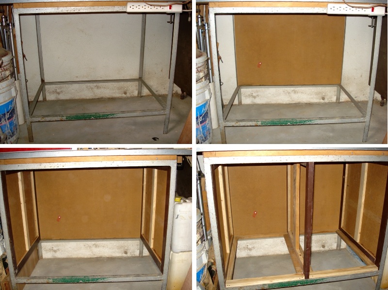

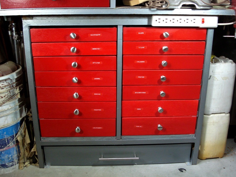

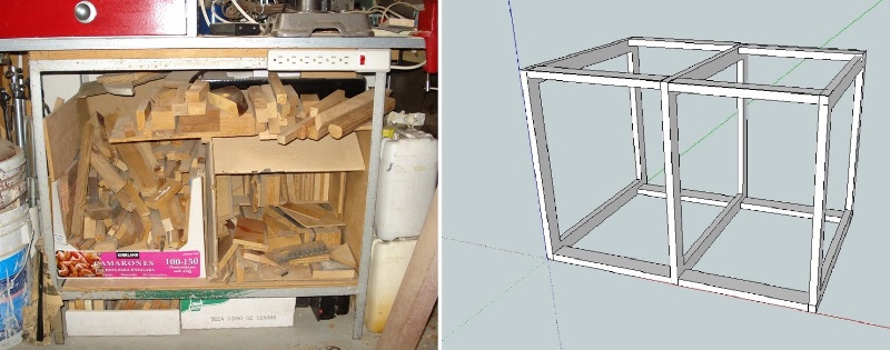

Along many years, the space under the drill press table (made with angle iron) was underutilized, and was occupied only for scrap wood.
The basic aim of this project was to get the most out the space available under this table, and to efficiently organize some tools and accessories.
Attachment 14152
Most materials were leftover or reused.

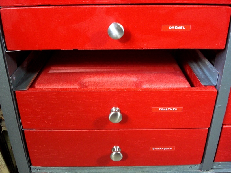

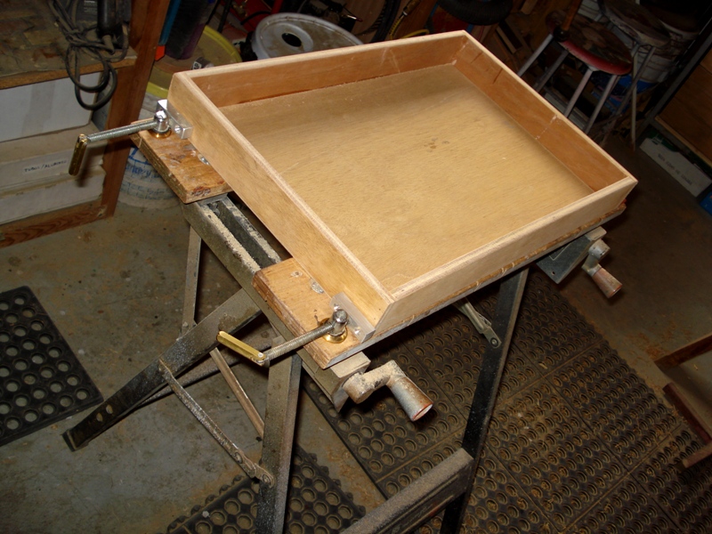

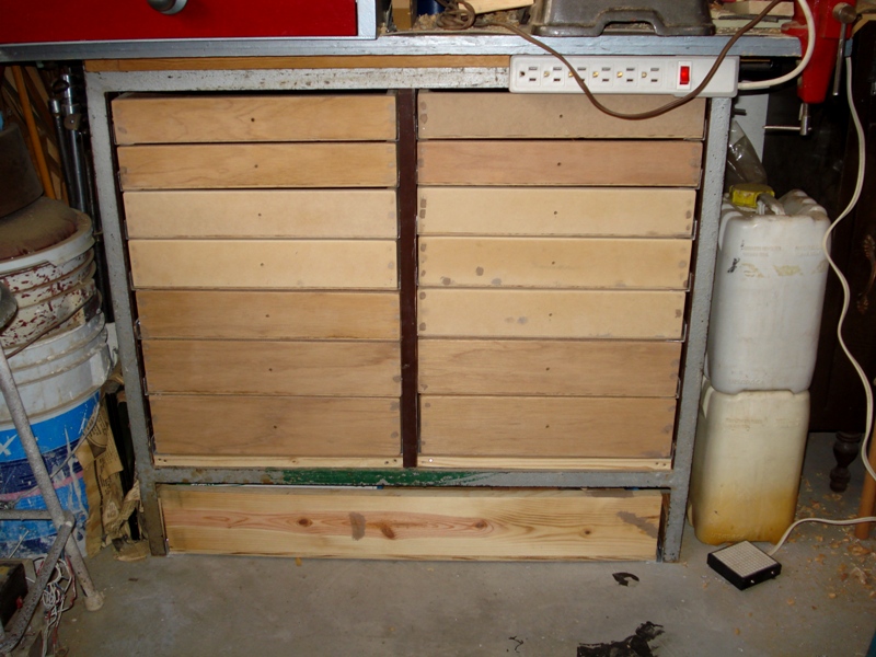

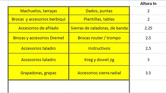

There are two rows of drawers, they are 52.5 cm deep, and 35 cm wide; the height is variable and took in account the destined content for each one of them.
