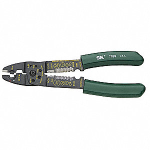

I just use a simple hand tool, screw in the fastener in the appropriate hole, squeeze the handles, unscrew the fastener and it's done.
Attachment 40901
That is fine for the limited number of screws it will handle. Not so good if you have anything else. I have three or four of those, from several different makers, and some picked up overseas, and none of them do anything but 4-40, 6-32, 8-32, 10-24 & 10-32. In the past year, and I've not gotten all that much time in my shop in this time, I've also run into 8-36, and 1/4-25, and several smaller metric screws, plus some more microscope screw holes I've not managed to figure out yet. Anyone working on antique American or Japanese sewing machines, for example, will need a bunch more, too. Retro's method will work for anything you have or can make a nut for.
