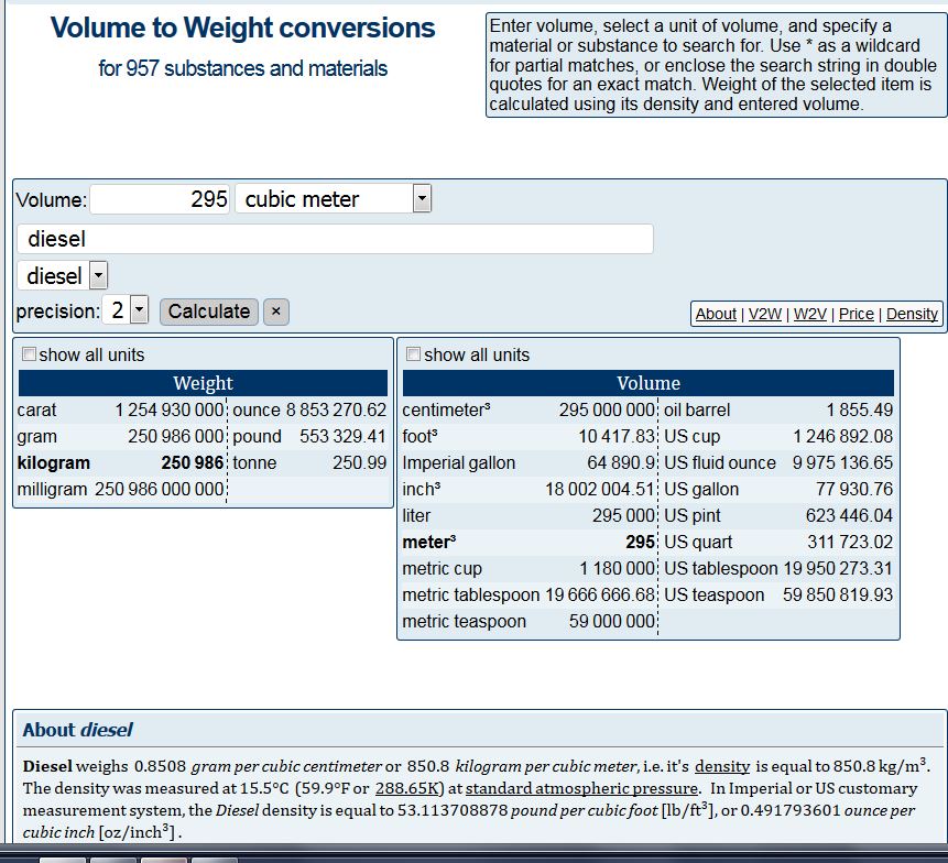

From Wiki Wartsila 14 RT flex 96C.
Good question, I was thinking the same thing.
Best specific fuel consumption 160 g/(kW·h)
Mass of fuel injected per cylinder per cycle ~160 g (about 6.5 ounces) @ full load
(Whole engine uses up to 250 tons of fuel per day.) That is about 300 m^3 (79251.6 Gal) of diesel Or ~10594 ft^3 of diesel/day x ~20 days to cross the Pacific...about 211,880 ft^3 or only ~60ft x 60ft x 60ft. (hope I got all my conversions and decimal points right) Surprising and Efficient, considering the size of a super tanker.
Attachment 26214

Me too, I woke up thinking about it. Basically its around 0.004 MPG or 21.243 Ft/Gal. I based it on a one way trip from Hong Kong to LA (shipping distance 6377mi.) and the gallons/day value divided by 24hrs and the guestimated 20 day trip. The other value that is interesting is the Mass of fuel injected per cylinder per cycle ~160 g (about 6.5 ounces) @ full load from above equates to about .8 cup of fuel per cylinder per cycle under full load. Not much at ~80 RPM (~4gal/minute).
