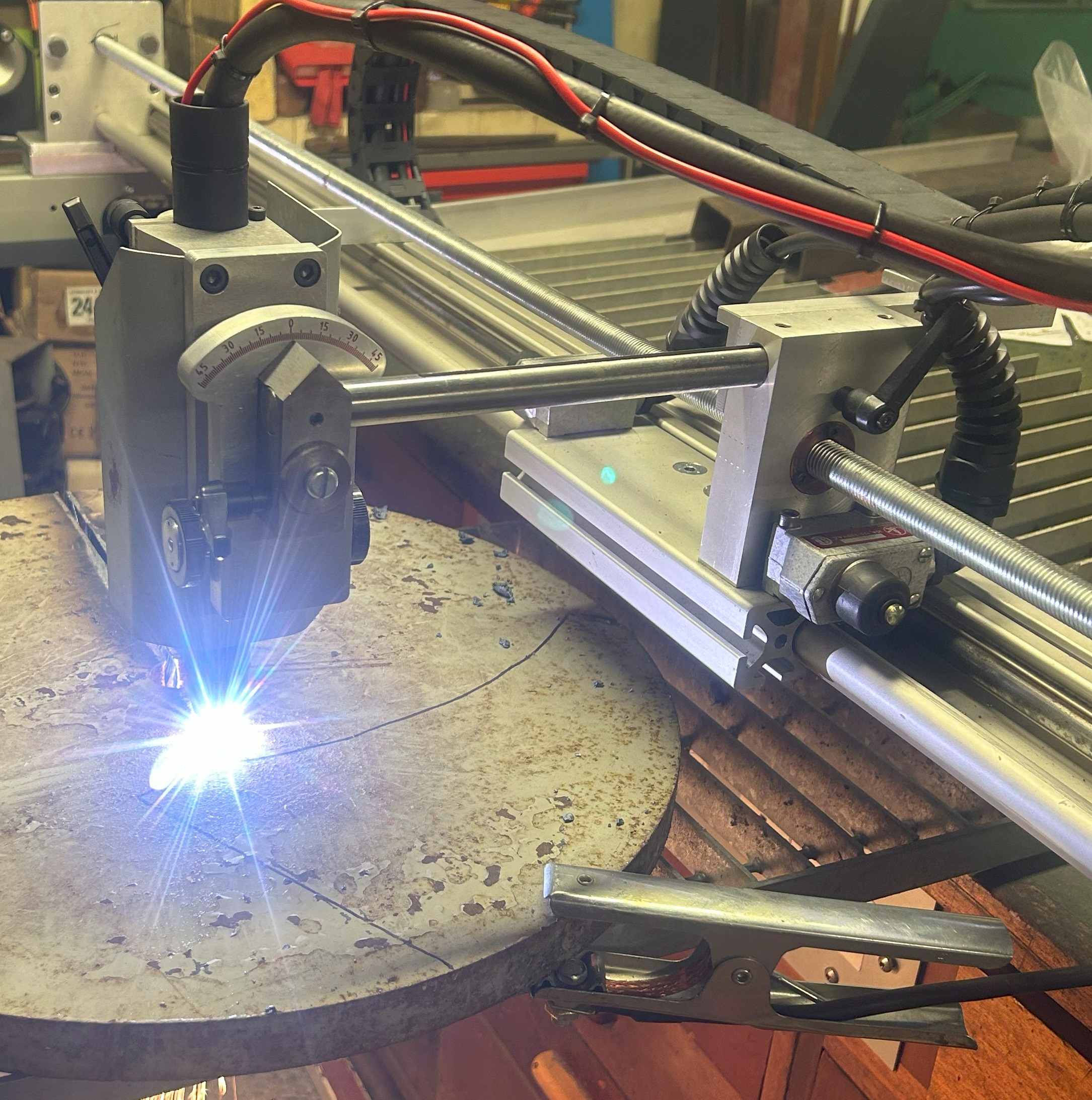

I am going to build a Ripper Tooth for my Mini Digger and wanted to cut some 26mm old plate to create the main body parts of the claw.

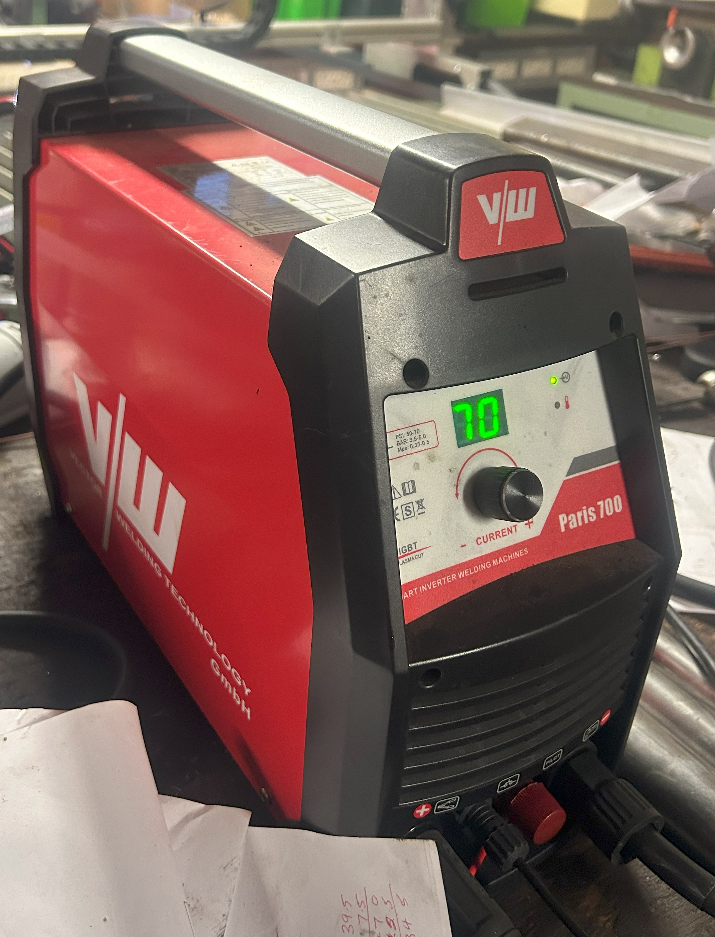

My plasma cutter is only rated at 24mm thickness of cut, so I was definitely on the maximum of the machine capabilities (so I thought:headscratch:). Set up the plasma track that had only ever been used to cut a maximum 10mm thickness of plate in the past with no issues.

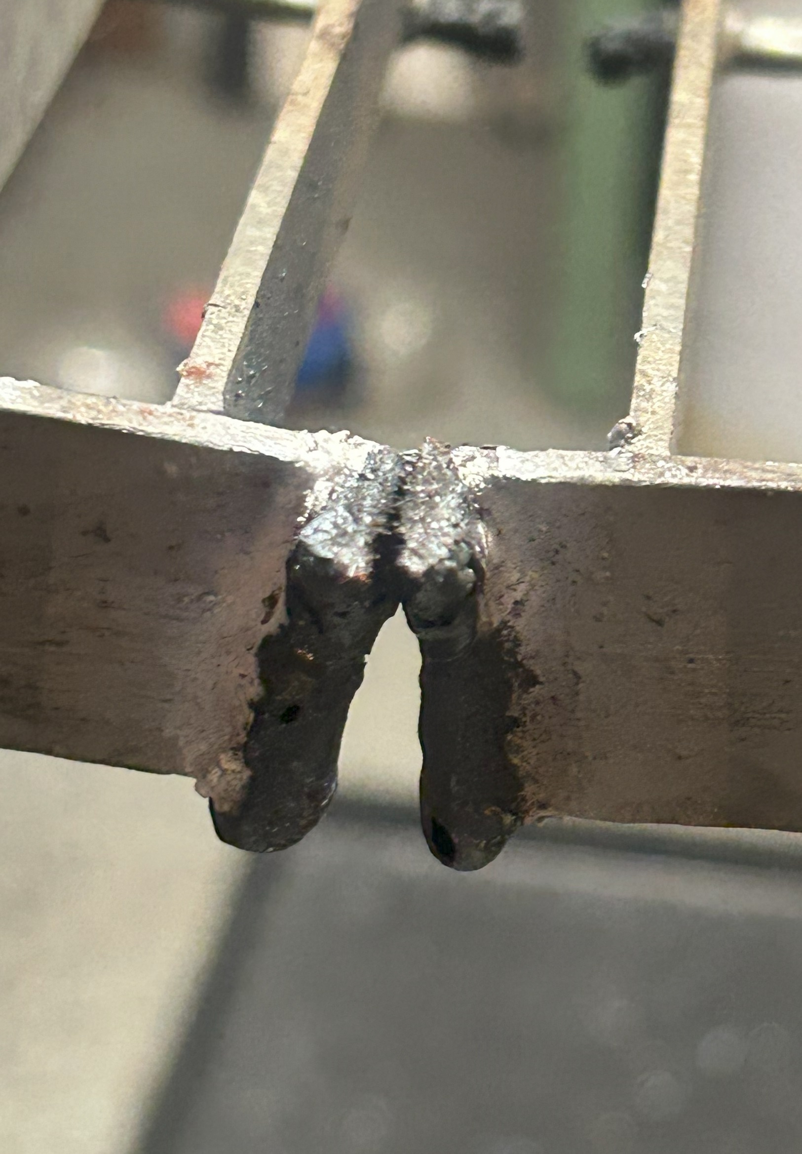

Well to my amazement the plasma cutter not only cut through the 26mm plate but the frame I had placed under the plate to support the material to be cut which was a further 20mm.
The control the track gives rather than cutting freehand I believe made this possible. I will post on HMT a separate posting on the cutting track
Attachment 48066Cutting the 26mm plate
Attachment 4806770 amp maximum output plasma cutter

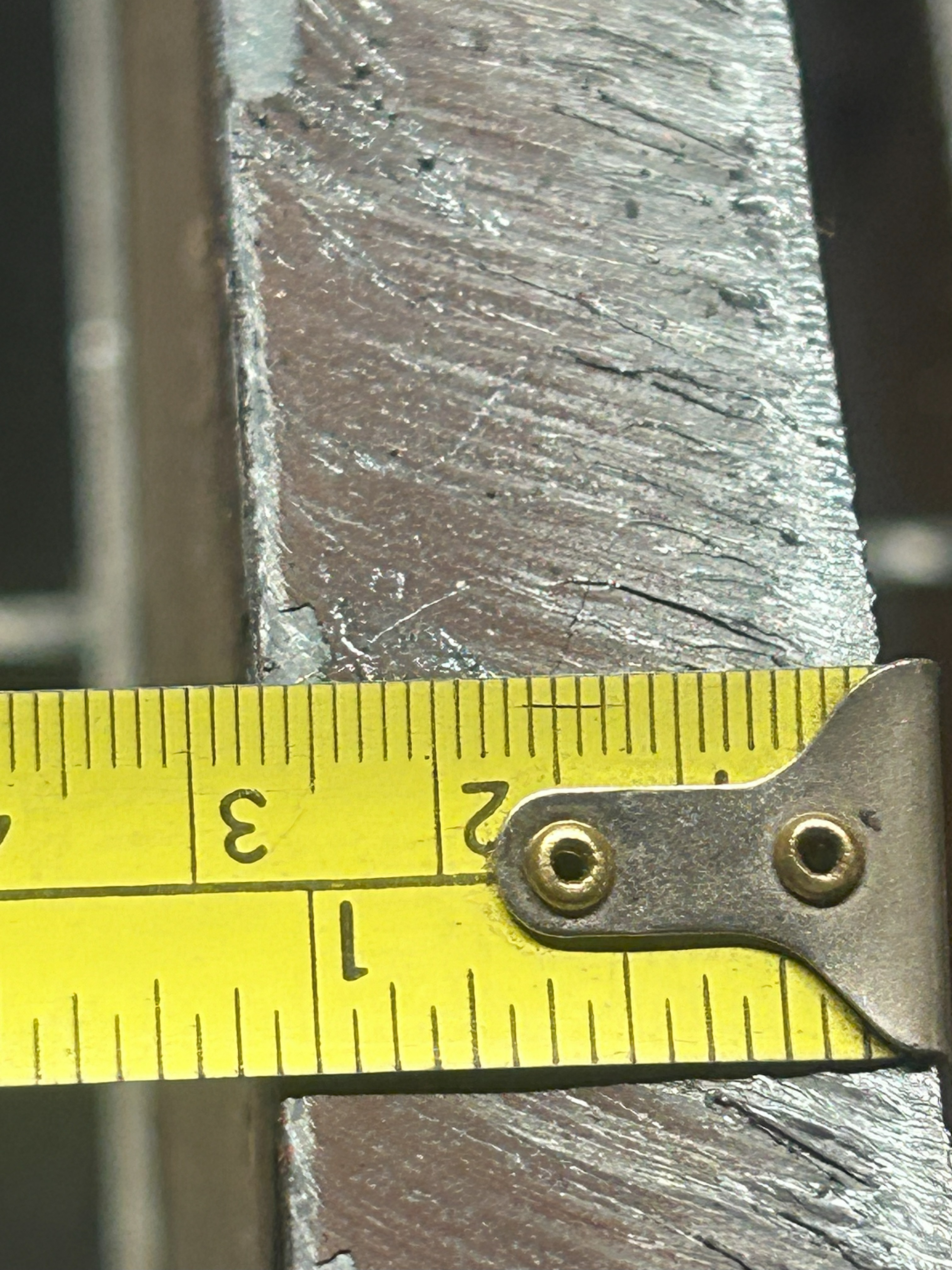

Attachment 48068Surface finish of cut

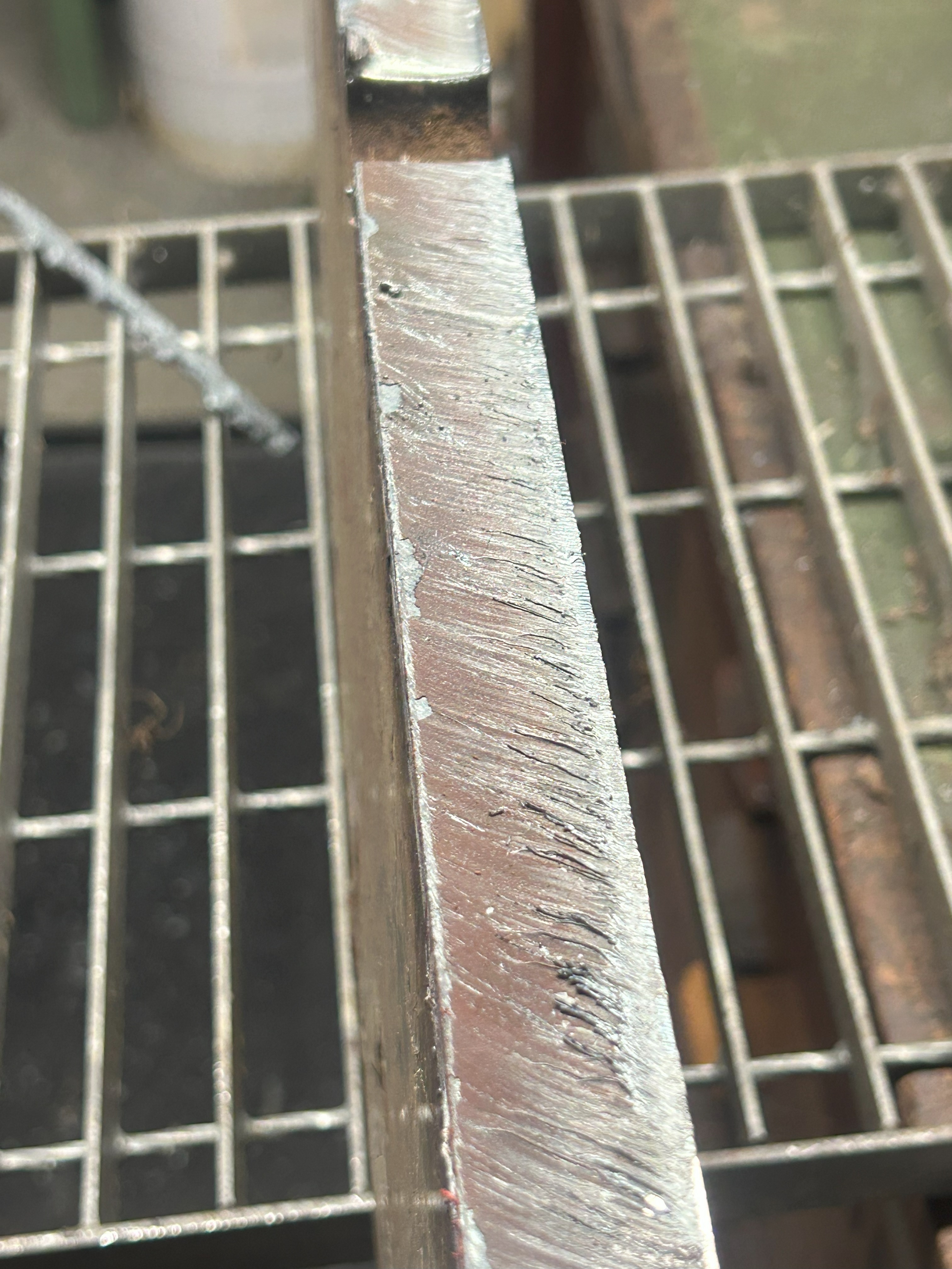

Attachment 4806926mm plate
Attachment 48070Cut table supporting 26mm plate
Really surprised not only at the depth of cut but the surface finish
