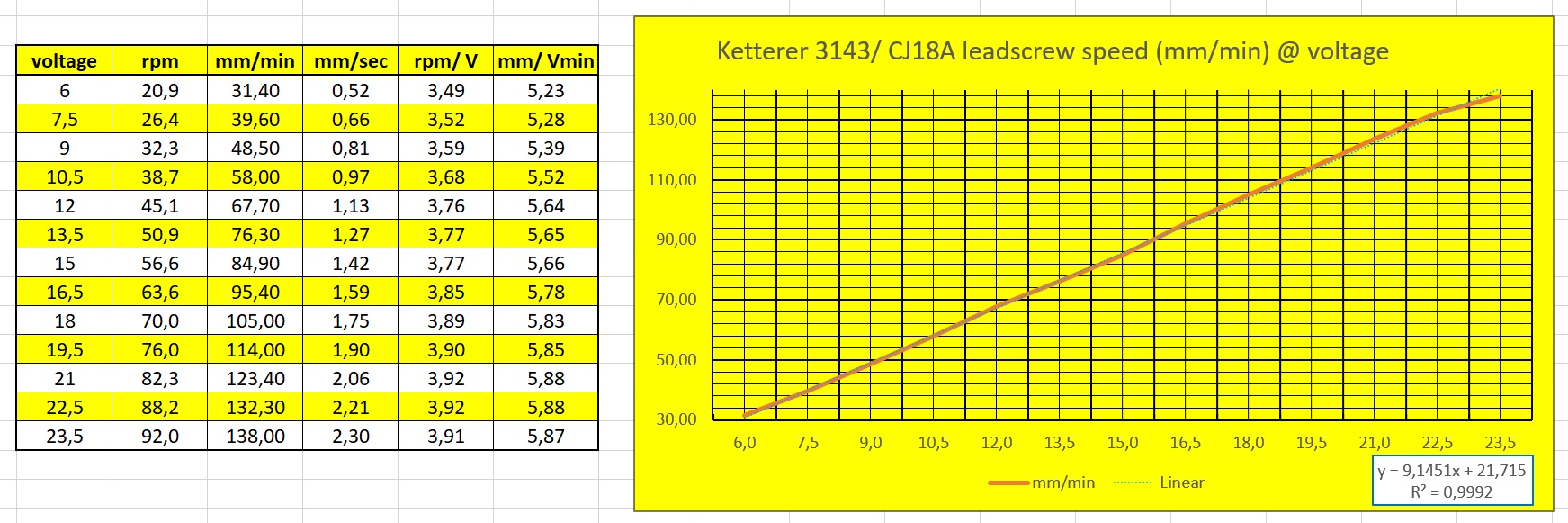

-Lessee some measurements:
Attachment 29895
So, data above are actual leadscrew values in a motor mockup when powered by 2 Dell DA-2 series connected PC PSUs,
that can crank out 18 amps, and a cheap BangGood 90V, 15 A, 1kW PWM module
-Yeah I know - the motor will weld itself shut, strip the half-nuts and/ or buckle the leadscrew in the meantime, before the fuse blows.
My speed values differed from the manufacturer's specs - but it'll do the job, it is small and easy to fit in,
and if I don't take crazy DOCs at wild feeds it'll have a better duty factor than stated for office table duty.

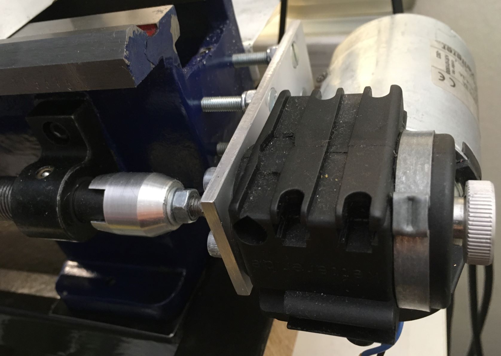

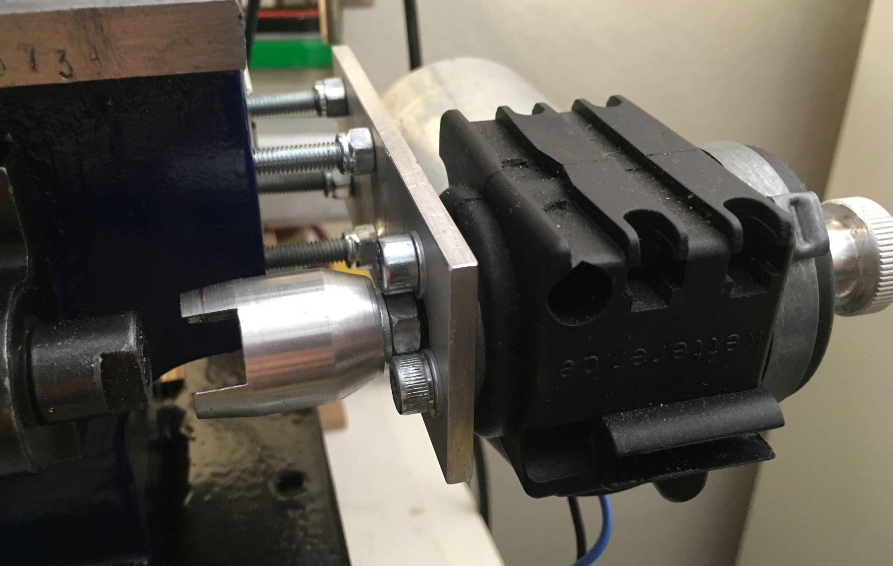

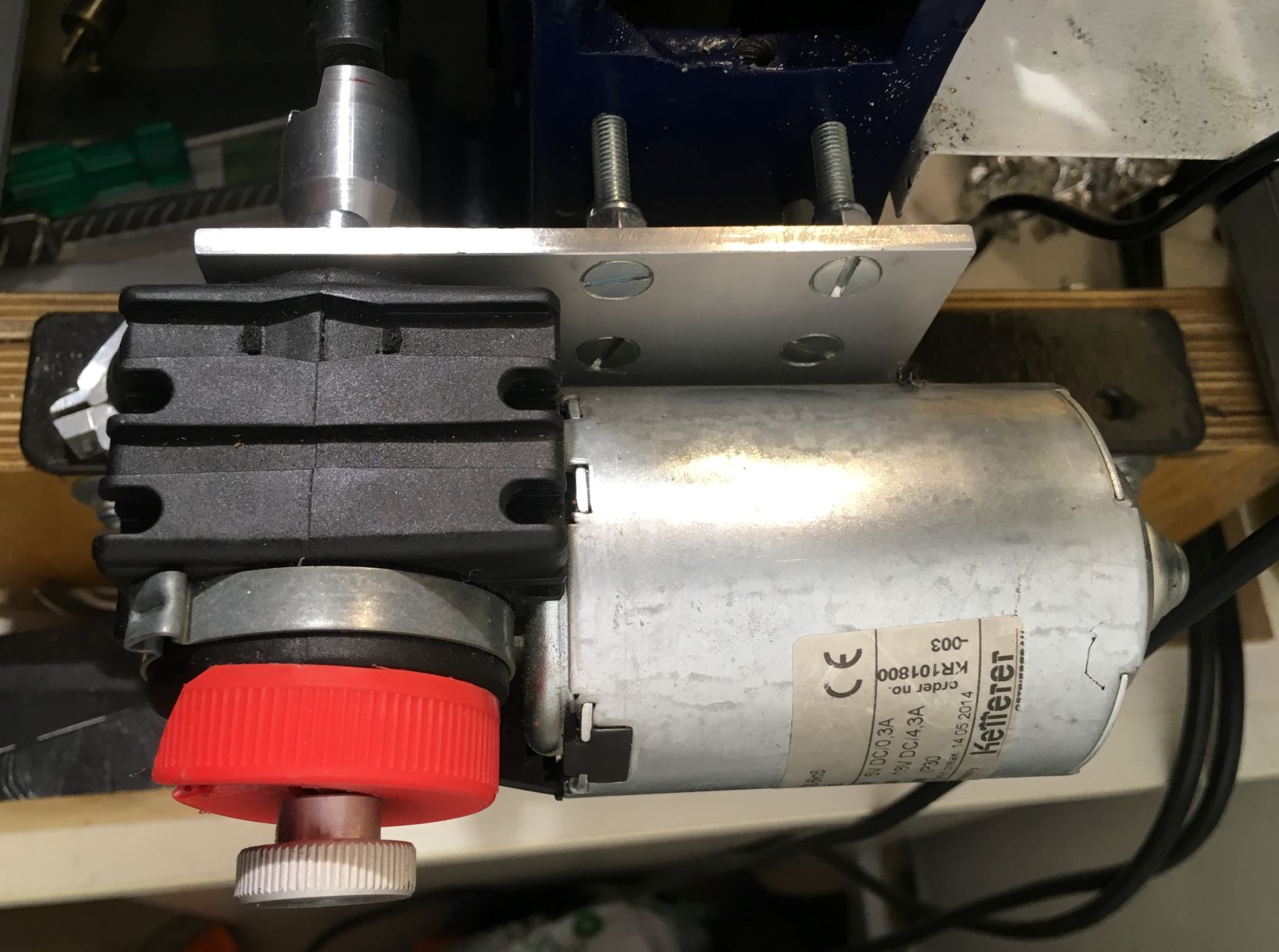

Attachment 29896 Attachment 29897 Attachment 29898
Left pic: No-frills attachment thru 4 x M5 bolts tapped into the bed end, small plate attached onto which the drive is bolted.
Red safety (yogurt can cap) still in place.
Mid pic: Clutch disengaged: just a piece of Al turned, threaded M5 and milled in the lathe, the 6 mm hex bar threaded M5 at both ends, a tiny Neodymium magnet keeps the clutch locked on, and a found knob was turned and loctited to the other end.
Right pic: clutch engaged - and has stood up thru time, as the lead screw's end nut now is tightly locked, it won't jam the bearing block any more.
Motor is hot to touch (but not at its Curie point yet :D) after an hour of rebar coarse turning. I have several of this motor if needed...
