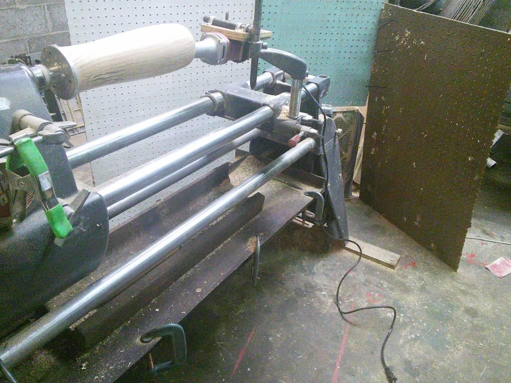

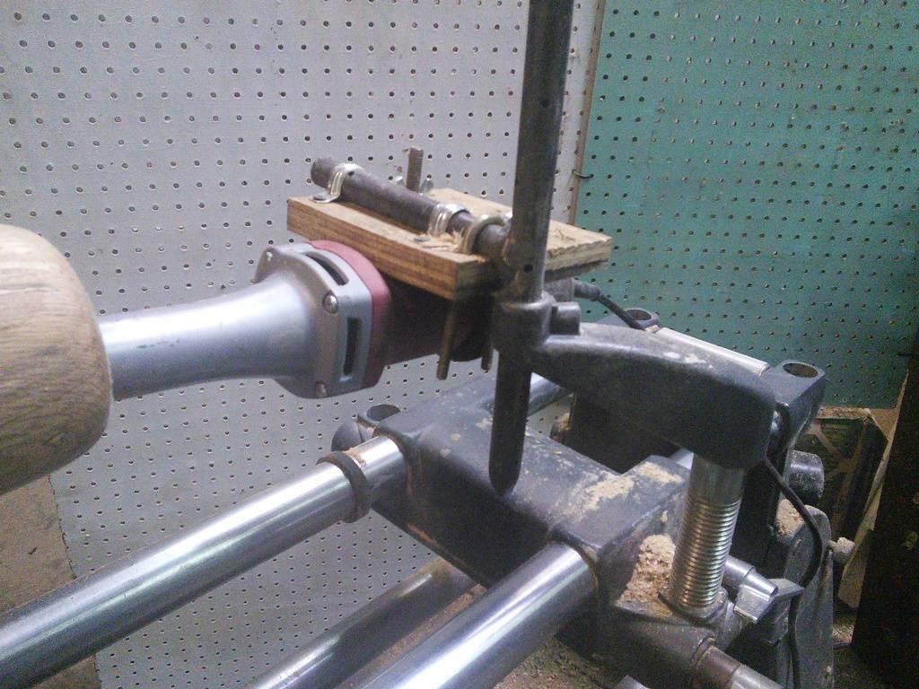

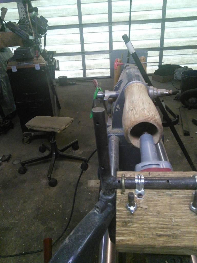

Recently this is my most used tool/jig. I have been doing a good amount of work with the wood lathe. My lathe doesn't like off centered chunks of wood ( I don't have a way to reduce the speed enough yet either). I have added a slap of rusty plate and some railroad track to the under side of the lathe to add some weight and reduce the shaking but its still not enough. So I made a jig to hold a router to the tool rest. I turn the log by hand feeding it into the router. This eventually gets the log balanced enough to turn under the lathes power.
The router interchanges with a long neck die grinder to hollow out the bowls. As I only have a few chisels and they are too short and don't like turning the inside out deep bowls.
http://img.photobucket.com/albums/v6...psj5lin7dz.jpg
http://img.photobucket.com/albums/v6...psqpq7cgam.jpghttp://img.photobucket.com/albums/v6...pshjrjiio6.jpg
Simple and functional, jere. Thanks for sharing.
