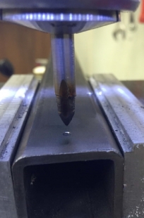

Homemade friction-formed boss method consisting of utilizing a ground HSS tap to deform the metal around a pilot hole with the goal of producing a tappable depth greater than the thickness of the tubing. Best results were achieved with a 7/64" pilot hole.
