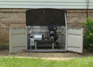

Homemade generator consisting of a Harbor Freight generator head driven by a 16 HP Briggs and Stratton engine.
Nov 13, 2016 2:08 PM
Nadogail
Built one of these myself, I used the 13 horse Grayhound engine from Harbor Freight and mounted mine on a cart. The Harbor Freight engine crankshaft was a little larger than the 1" Lovejoy, so I opened the coupler up with a drill mounted flap wheel. I used a Rubber Maid garbage can shelter with a plywood floor inserted to accommodate the casters under the generator.
With our exceptionally steady electric service, t is used mostly as a portable power source for my stick welder.
