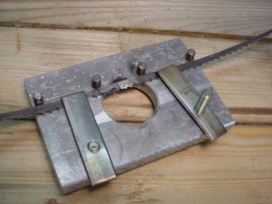

Homemade Bandsaw Blade Brazing Jig
Homemade bandsaw blade brazing jig constructed from galvanized heating duct. Intended to facilitate the process of attaching the ends of a broken blade. Alignment of the two halves is assured by the four pins.
