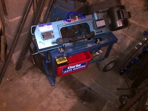

Homemade bandsaw stand fabricated from 30mm box section steel and utilizing a parts washer as a coolant pump. Incorporates adjustable feet opposite the wheels.
