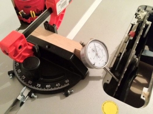

Homemade dial indicator holder setup utilized to measure runout on a table saw blade. Also aides in checking for play when a sled is run through the miter slots.
