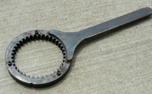

Homemade clutch center nut removal tool intended to prevent a clutch drum from turning during removal operations. Tool was constructed by bolting steel clutch plates together and welding a handle to the uppermost plate.

I had those moments where the solution is staring right back at you. Nice job of making a clutch tool out of clutch components.
