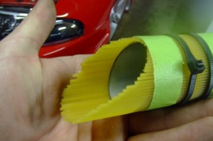

Homemade contour gauge consisting of spaghetti wrapped and zip-tied around a length of pipe. Serves to facilitate accurate tube notching.

At first glance, my mind said spaghetti but decided it was a set of those kids' pickup sticks. Great idea, but I'd rather eat the pasta and use pickup sticks.

This really caught my attention. It may look funny to some but there is no doubt about the tool's functionality.
