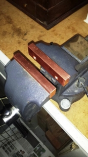

Homemade copper soft jaws for a bench vise. Fashioned from 8" x 4" x ½" copper bar stock. Intended both to prevent marring of workpieces, as well as to function as a heat sink during silver soldering.
