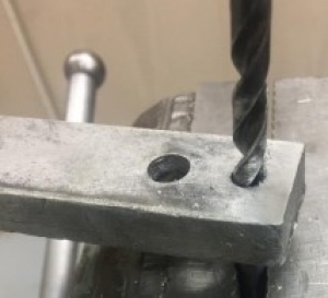

Homemade dome head drill guide constructed from surplus bar stock. Useful for starting a drill on rivets but also works on round stock.
