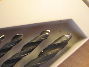

Homemade drill bits for plastics featuring optimized profiles of tip angle of 60°, a flat 4° rake, and a clearance angle of 12°
