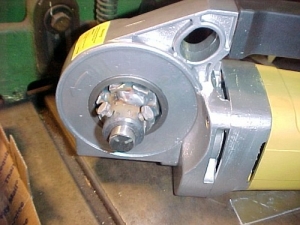

Homemade drive adaptor for a HF pipe threader fabricated from 3/8" steel plate. Eight segments were formed around a 1-1/4" spindle and welded in place.
