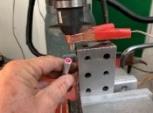

Homemade Edge Finder Runout Compensation
rgsparber on homemadetools.net
Homemade edge finder runout compensation constructed by installing colored dots on a milling machine spindle and collet. Reduces error due to runout.
