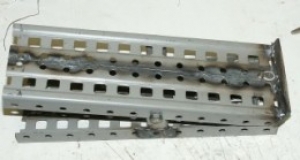

TIG pedal made from scrap 2.5mm L-channels. A cord is wrapped to the potentiometer shaft with the other end at the pedal. Microswitch from a PC mouse serves as the pedal's on/off switch.

Not the way I would have built it...in fact...this is more high tech....
Very neat idea here.
