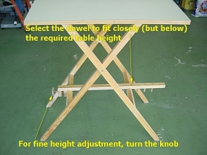

Homemade folding table incorporating both coarse and fine height adjustment. Capable of utilization as an extension to a drill press table or as a table saw's infeed or outfeed table. Top can be melamine, plywood, or other material appropriate to the intended use.
