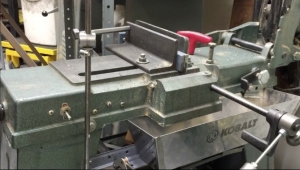

Homemade Friction Rod Downfeed
rgsparber on homemadetools.net
Homemade friction rod downfeed for a horizontal bandsaw. Comprised of a steel rod, a length of rubber tubing, a small hose clamp, and a cross-drilled cylinder. Feed rate varies with hose clamp tightness.
