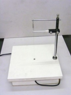

Homemade hot wire cutter for polystyrene foam. Consists of a 300 mm square table, a column with two arms, and a 36 SWG nichrome wire. Runs on 240v mains with a 12 volt transformer connected to the hot wire. Column arms are insulated by a plastic collar. Accessories include fence, circle cutting jig, and sliding square made from MDF.
