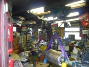

Homemade jib crane fabricated from scrap steel offcuts. Utilizes a Lidl hoist. Jib tube was cut from 3 1/2" tubing and welded to a 4" x 2" x 3/8" thick tube fitted with Nylatron bushes.
