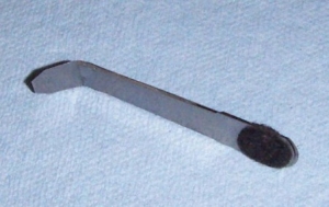

Homemade KTM Feeler Gauge
creeper on advrider.com
Homemade angled feeler gauge utilized to inspect the valve clearance on a KTM LC4. Adapted from a standard .006 feeler gauge with a short section bent to approximately 45 degrees and two thicker pieces of metal epoxied to the opposite end to serve as stiffeners.
