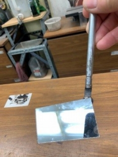

Homemade large inspection mirror constructed from a mirror, angle iron, steel rod, ball bearing, a neodymium magnet. Mirror is detachable, and pivots on the countersunk magnet.
