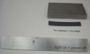

Homemade laser printing technique intended to transfer toner to metal and other smooth surfaces. Artwork is printed on parchment paper with an ordinary laser printer. Toner is then transferred by gluing the printed artwork to the receiving surface. A cover coat of shellac or enamel is then sprayed for protection.
