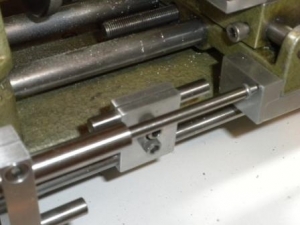

Homemade lathe carriage and milling stops fabricated from 6061 aluminum. Limit rods were fashioned form O-1 drill rod. Adjustable stops are secured in place by 8-32 cap screws.
