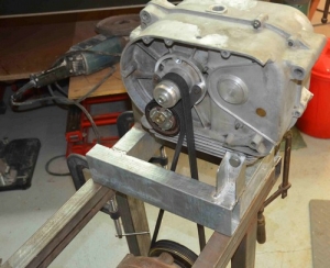

Homemade Lifter Tester
tonyfoale on homemadetools.net
Homemade lifter tester constructed from a homemade cylinder with viewing ports, a reflector, an LED strobe light, control software, an electric motor, and a camera. Enables one to observe valve float, rod bend, lubrication, and other parameters.
