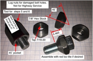

Homemade lug bolts constructed from hex bar stock. Intended for use on a lawn tractor.
