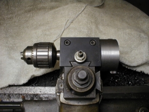

Homemade machined QCTP drill backup provides a solution to the problem of a rotating QCTP when holding a drill. Utilizes a sleeve in the boring bar holder, which is connected to a backstop. Also doubles as a turret holder.
