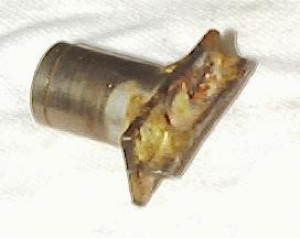

Homemade oil filler neck removal tool for a VW Beetle engine. Tool was fashioned from a 3/8" drive socket with sections of scrap steel brazed in place.

I don't know if I would have made it look the same, but the idea of have a way to remove those large slotted heads is excellent.
