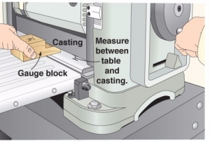

Homemade Planer Gauge Block
Kenneth Keen on tips.woodmagazine.com
Homemade gauge block intended to facilitate thickness planer adjustments. Tongue is cut to the desired thickness.
