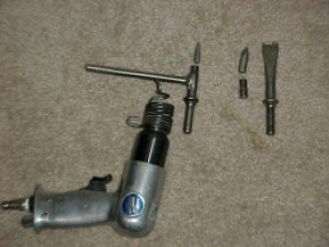

Homemade tool for removing rusted screws. Uses an air hammer (riveting gun) tip with a 1/4 inch socket welded to it to accept screw tips.
