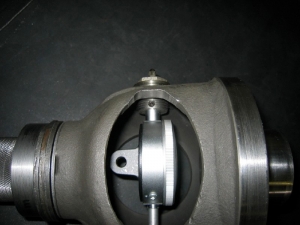

Homemade reproduction of the Porsche P258 differential tool, utilized to measure the spacing between an axle's centerline and the pinion. Adapted from a surplus differential carrier and featuring an internally mounted dial indicator.

very nice. Are there any plans available that show dimensions?

This looks factory made! Very nice.
