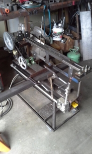

Homemade power hacksaw fabricated from steel angle and flat bar stock. Saw guide arm consists of two lengths of 1" square tube in parallel. A pulley-reduction system enables the saw to run at 70 strokes per minute.
