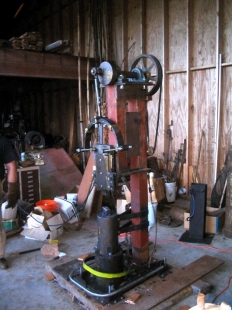

Homemade power hammer modeled after a commercial Champion unit. Hammer utilizes a 3" driveshaft with a 2" pin set on the edge of an 8"x2" wheel, yielding a 6" stroke. Hammer operates via the slack belt principle.

hey geoff, how do I get your plans for your power hammer.

Hey Geoff, why haven't I seen this on the blade smith forum ??
