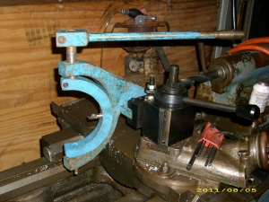

Homemade radius turner for a lathe fabricated from 1-1/4" plate. Mounts to an Aloris-type tool holder. Bottom pivot consists of an Allen bolt with a jam nut and is intended to facilitate centering.
