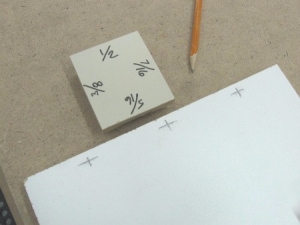

Homemade reveal and measuring gauges intended to facilitate the process of locating screws. Comprised of MDF blocks rabbeted at different widths. Also doubles as a height gauge.

Simple and easy to use. Slip it flush and you're done.
