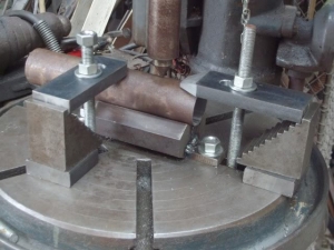

Homemade jig for drilling round stock. V-block made by welding two hex bars. Tabs are welded on each end for the studs. Centered using a cone Morse 3 center and secured using T-nuts. Used together with hold downs.
