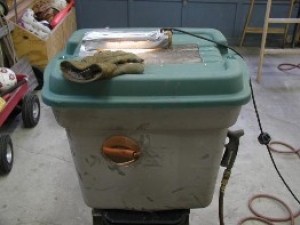

Homemade sand blasting cabinet adapted from a Rubbermaid storage tub. Lid was fitted with a Plexiglas window and a fluorescent drop light.

For occasional use, this would work well. As with all sandblasting setups though, one has to look hard at the air compressor's capacity.
