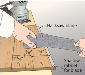

Homemade Sandpaper Cutting Jig
Lynn Lawrenz on tips.woodmagazine.com
Homemade sandpaper cutting jig comprised of a stepped wooden board fitted with a hacksaw blade.
