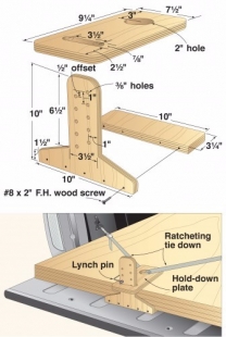

Homemade Sheet Goods Hold Down And Stop
Joe Spurlock on tips.woodmagazine.com
Homemade hold down and backstop intended to secure sheet goods for transport in a pickup truck. Constructed from plywood.
