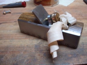

Homemade smoother fabricated from O-1 steel and bocote. Has a 55-degree bedding angle, 6" sole, and equipped with 1-1/2" wide iron.
