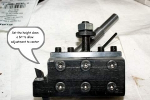

Homemedmade tangential tool holder intended to fit an AXA tool post. Machined from two pieces of 1/4" steel. Grooves offset to 12 degrees were milled in the steel plate to produce the desired angle. Six holes were tapped and counterbored to accept 12-24 stainless steel screws.
