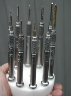

Homemade tap wrenches fabricated from 7/16-20 bolts. Hex end is drilled to accommodate a 1/4" shaft, then rounded over. Bolt threads are knurled for improved handling.
