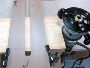

Homemade Tapered Sliding Dovetail Slot Jig
Bricofleur on lumberjocks.com
Homemade tapered sliding dovetail slot jig constructed from 7mm high-density fiberboard. Intended to be utilized in conjunction with a guide bushing on the router bit.
