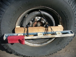

Homemade toe alignment rig utilizing a laser level. The rig is secured to the wheels with bungee cords. Toe calculations are based on the distances recorded.

Looks so simple, but if you do your setup carefully, it can be just as accurate as those fancy rigs at alignment shops.
