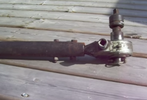

Homemade torque multiplier constructed from a slack adjuster off a large truck, sockets, and pipe.

Manitoba Man
I like that torque muliplier. I was wondering what your ratio was on the slack adjuster. I know my father had a German made commercial unit and it gave a 22 to 1 multiplication ratio. Great for removing pad bolts on Caterpillar tracks.
