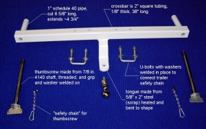

Homemade trailer hitch constructed from square tubing, flat bar, thumbscrews, U bolts, chain, pipe, and a hitch ball.
