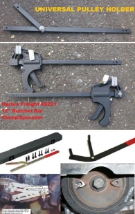

Homemade universal pulley holder inspired by the OTC 4754 tool and intended to facilitate the process of loosening the crankshaft pulley of a Mazda 1.8L FP engine. Constructed from two flat bars, sourced from HF ratchet clamps, and two M8 bolts.
